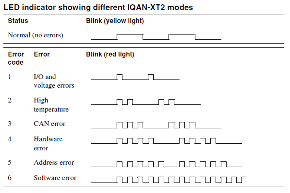

The XT2 is not a unit that you download any program to, it is an expansion module and only sits on the CAN bus and listened to what the master tells it to do.
So you will no be able to unlock it for programming.
The yellow diode shows during normal operations with a steady blink.
There should be a red diode (same light strip) that blinks if the XT2 detect an error.
Depending on what error different number of blinks is shown.
Image 5508
And if only the green LED is showing it could indicate that either the led is broken or the processor that sends the blink code is not working.
If you tested the modules in a machine that you know works and you get the same error there it sounds like they are damaged somehow.
