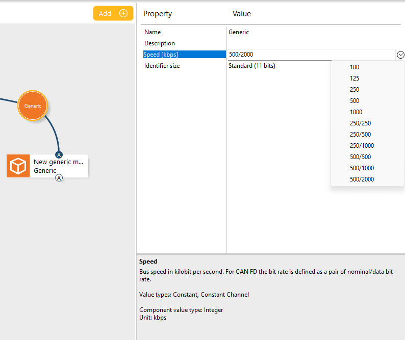

I just purchase the latest version (IQAN design 7.02), did a quick new project creation on a MC43FS on and I couldn't get flexible data rate, neither on the speed or DLC :
Image 4498
Image 4497
What Am-I doing wrong, am-I not well understanding what's CAN-FD ?

So if I well understand it's only used / supported for "proprietary" IQAN nodes communication port, not on other system interfacing ports. Are you planning to expend the controllers capability by implementing these protocol options (Datalenght + Frequency switch) on "User"'s CAN as well ? I've to deal with a "generic" FD can at the moment and it unfortunately sounds like IQAN MC4 serie could be an option ;( but I was hopping it could be one in the future...
The ability to use CAN FD on the IQANdesign Gerneric CAN is another case we are also looking at.

Support for CAN on generic CAN implemented in 7.05
