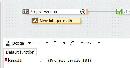

I run into the same issue. I would like to convert 'Project Version' into a number so I can send it via J1939 to our telematics system. I cannot.

A string text is an array of characters.
Why it is actually impossible to cast a string text into array object (equivalent to memcpy function in C Language) ?
It will be a revolution to have this in next release of IQNA Design:
 -> From array object, we can have a way to convert S/N into integer..
-> From others subjects, they can compare text strings, etc..
