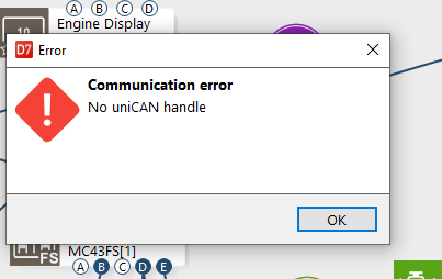

Normally i would just revert back to CAN programming to try to just do the MC43 by itself  but with the V 7.05 i can not get my peak adaptor to connect anymore. I updated the drivers to 64 bit and confirmed in my PCAN view I'm running 64. but I get a no uniCAN error. I then tried to go back to my 6.08 software to test and now it wont work there either as it gives me a communication error and wont connect. It had worked for the last several years until I updated my Peak to 64 bit

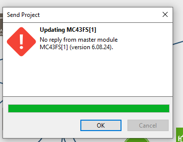

I got a new MC43 to test with and it will not update from blank to 7.05. When trying to program 7.05 It kept giving me this fault:
Image 5130
I then moved back to a 6.08 program and it took that on CAN and Ethernet. So then i tried again with 7.05 and would not take with my actual program. I then made a blank 7.04 program and it finally updated over CAN and ethernet. I then tried to make a blank 7.05 program to get it to update over CAN but it just gives me a noUNICAN fault. Seems strange based on that it just worked to update to 7.04.Definitly some issue there. I then tried with ethernet and it updated it to 7.05. I then tried my actual program and it uploaded successfully.

In conclusion MC43 modules will not program from 6.08 to 7.05. I can not get 7.05 to program over CAN I assume that's due to the ability to change bus speeds for diagnostic bus, but I have left mine on 250. I could successfully program with 7.04 on CAN with no change to my setup it will fail on 7.05 with No uniCAN Handle fault

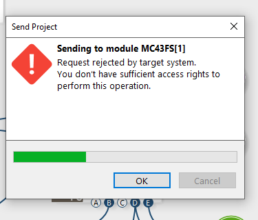

ON the above I used a bench harness. ON our unit The screen would take the 7.05 program but the MC43 never would update. I tried to move backwards to my original 6.08 program to get them both on the same so that it could function. I got this fault which was strange being I made these programs.
Image 5132
It would not let me step backwards to 6.08. I changed the passwords just to try and no change. I made a 7.04 program and that took. Then the 7.05 worked after.
Problem with PEAK adapter solved in IQANdesign 7.05.27
IQ-13778PEAK adapter not working in 7.05
PCAN-USB adapter without FD did not work in 7.05. Fixed.
