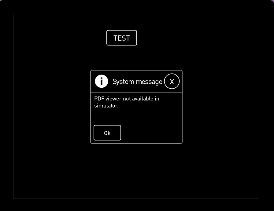

I made two projects (In IQANdesign 6.08.x and 7.06.x) where I had a text button open a PDF and got this message:
Image 5330
Is that the message you got?
Last time I used the MD4 for viewing PDFs was several years ago, so my memory is a bit blurry, but I recall testing the PDF viewer on the hardware. I believe that you can not use the PDF viewer in simulation just as the message dictates.

That is the message that I am getting on the actual MD5 hardware as well as when running the simulator.

Ah, I see! It is on the hardware as well. This got me thinking though and I had a vague memory (again😊) that, in an old post in the forum, Parker had a list of not yet implemented functionality regarding the MD5. I looked it up and found this:
MD5 software, missing features and known issues / Knowledge base / IQAN
which says that support for PDF reader is planned.
This will not solve your problem but at least you know why it is not working.
