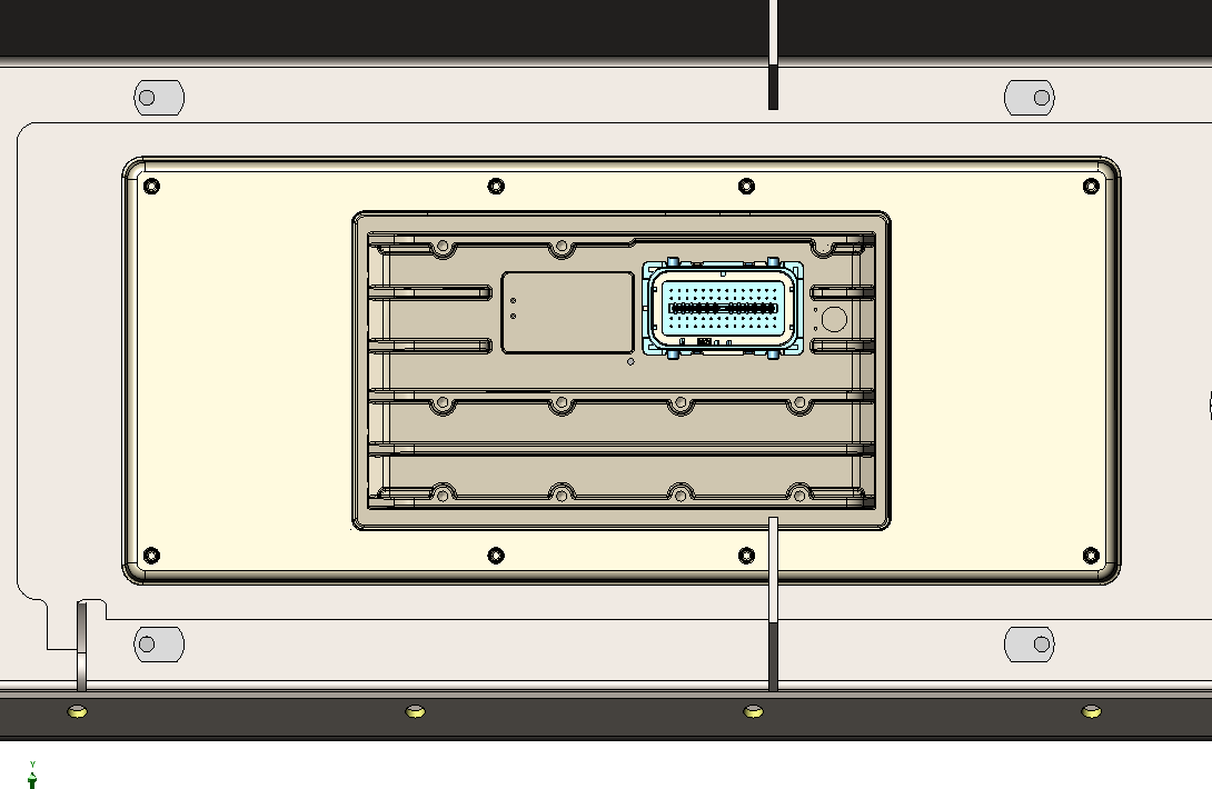

Can anyone tell me how far these clips stick out beyond the recommended panel cutout? Trying to design the spacing for the oversized hole that the panel will bolt to and don't have any information on the dimensions of these clips.
Image 5365
To answer my own question, they seem to protrude roughly 1 cm outside the front flange of the MD5-12 uncompressed. I imagine these will tend to flare out a bit more when compressed on a panel.
Are the holes these clips screw into really unthreaded plastic with self tapping screws on the clips? I worry about the durability of a design like that. What happened to threaded inserts or a metal chassis like the MD4?
The VESA mounting holes in the heat sink are a nice touch, but it seems like the panel mounting provisions were a half-baked afterthought.
