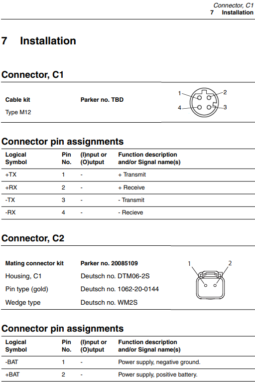

You can find the wiring of the M12 connector in the IQAN-SV instruction book, it is wired according to standard ethernet M12 D coded connector:
For connecting to MD5 ethernet port 2 - which is typically used for cameras:
C1:18 Ethernet 2 TD+ (not available on MD5-5)
C1:19 Ethernet 2 RD+ (not available on MD5-5)
C1:4 Ethernet 2 TD- (not available on MD5-5)
C1:5 Ethernet 2 RD- (not available on MD5-5)
For connecting to MD5 ethernet port 1 - eg. on MD5-5 or for a second camera without ethernet switch:
C1:15 Ethernet 1 TD+
C1:16 Ethernet 1 RD+
C1:1 Ethernet 1 TD-
C1:2 Ethernet 1 RD-
