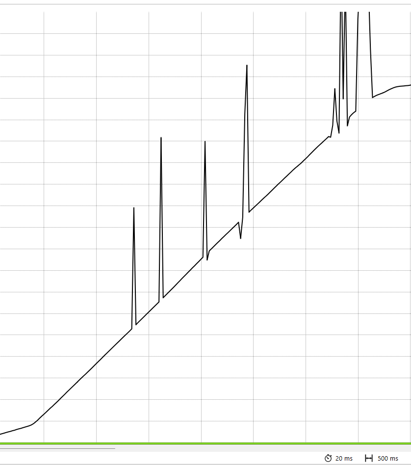

I have no problem with any others sensor types, but with almost all current sensors (4-20mA), I get an error with the signal (24mA) after some use.
But not all the time.
For exemple, here I have some undesired spikes while measuring.
Spikes are very short so I can't read +24mA in IQAN but I think if there was longer, I would have 24mA, so more than my scaled value at 20mA
Image 5198
For this exemple, the value come back to a good value quickly, but sometime it stays in error ~= 24mA
