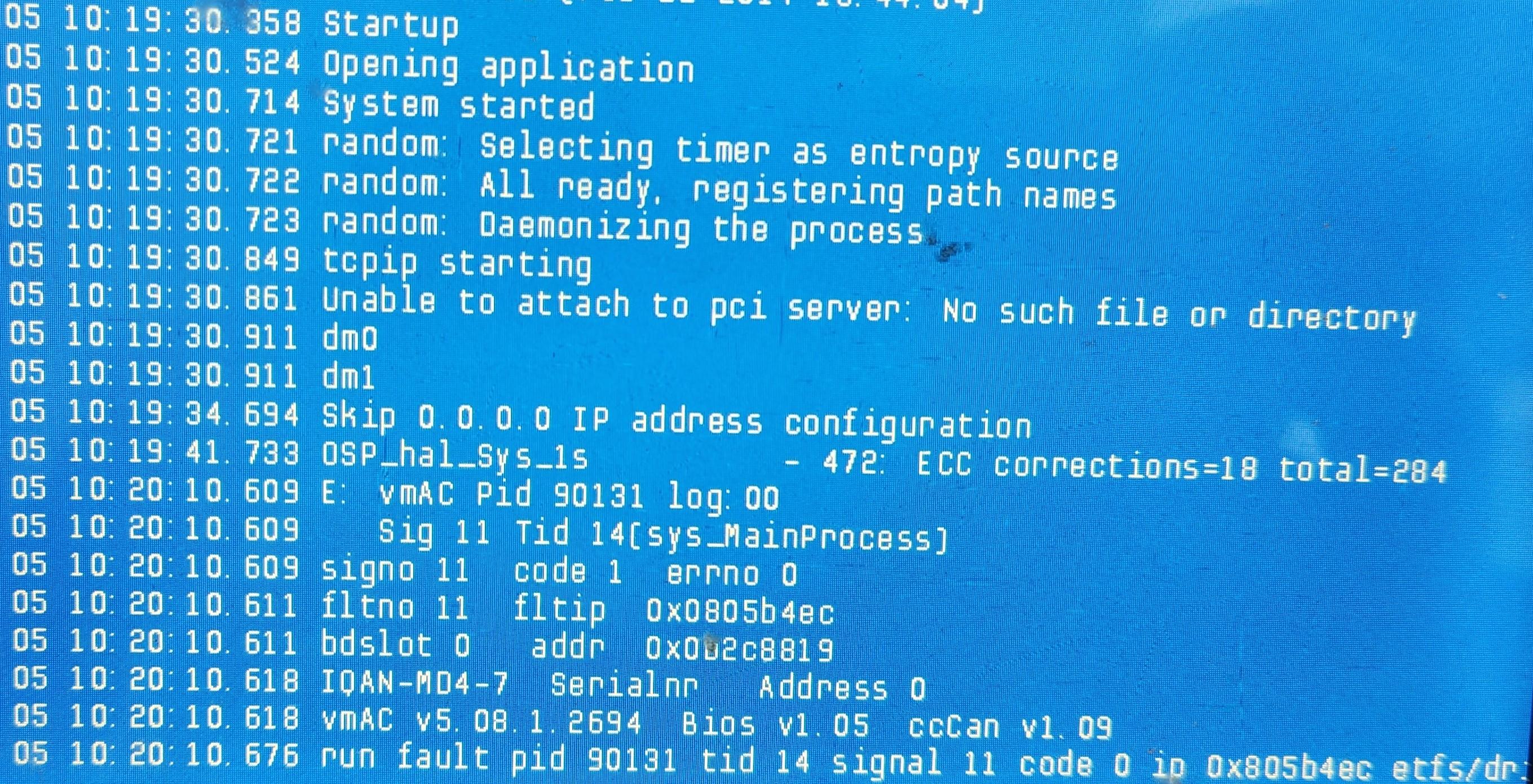

Did you get a photo of the bluescreen?
That would show some additional information, including SW version.
Yes, I'm sorry i forgot to add it to the first post.
Image 5222
This is the bluescreen it gets stuck on.
The bluescreen shows the MD4 is running a relatively old SW version, 5.08.1.
An easy thing to do should be to upgrade and see if this changes the behavior, I recommend 7.02 or newer.
