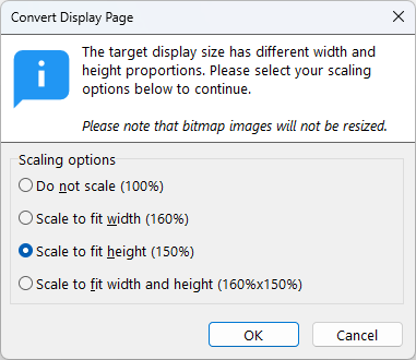

IQANdesign display page conversion
IQANdesign 7.05.25 introduces a display page conversion feature.
It is now possible to drag and drop display pages between modules of different size, with the option to scale the pages to fit the new size.
Image 5063
Example of conversion from MD4-7 to MD5-8
When scaling, display controls are resized and repositioned to fit the new size. SVG images are scaled automatically.
